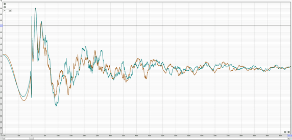

A little bit info about my version of Audiolense and my measurement system. I have version 5.5 and a 6.0 beta. They both yield results different from each other. I'm curious about whether or not my issues will be better addressed by a more recent version of Audiolense? Also, my measurement system may be the culprit. I'm currently using a UMIK-1 fed into a windows laptop via USB which is also connected via USB to an RME ADI-2 Pro FS R which is connected to my Genelec 8341As via AES. I am controlling everything via Asio4All. I've read that Audiolense supports the UMIK-1 but I'm wondering if a Motu M2 and an Earthworks microphone would solve these issues? I 100% understand that there are multiple clocks in my measurement system but my understanding is that this has been rendered irrelevant by enabling clock drift compensation. One reason I'm thinking I'm experiencing clock drift issues is by viewing my post correction step responses from both versions of Audiolense. Neither look right. The 6.0 beta looks quite odd:

38552

- Does the forum agree (or disagree) that my left channel group delay issue could be causing my soundstage pull left?
- I'm willing to upgrade to the current version of Audiolense if there is reason to believe I'm experiencing a bug or clock-drift compensation is more robust now for a Umik-1 implementation
- Also, I'm willing to buy a Motu M2 and a better analog mic if it is believed that is the way to go
Thanks in advance for feedback and input!

I am not familiar with the Audiolense, however your issue is not from the Audiolense, it is related to several things...speakers placement, Amp and preamp balancing issue between the 2 channels and so on. The type of equipment/ i.e. speakers you have?. The problem you stated sounds like in the setup ... location of your speakers. They should be at equal distance from the side walls. I would start with adjusting the speakers location. Take the impulse Response to find out the time delay in each channel and adjust speakers placement to get both channel/speakers at the same time delay.

As far as I know, Group delay below 100 perks is not audible. Above 100 shirts there doesn’t seem to be much of a difference between your two channels. Can you also show us the frequency response? Is there any part of the frequency spectrum that’s louder by a couple decibels over a broad area?
