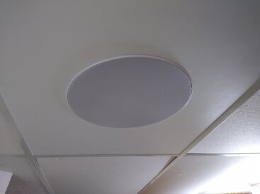

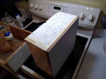

I installed these 2 weeks ago, and love them. I have them on a separate amp and was curious how much the Atmos speakers were used. I turned off the main amp and had only the Atmos speakers running. There is very little that is produced by them, but what they do is dramatic. On a second note the abs back enclosures don't fit the 15 degree units, so I built some plywood ones. All of my Atmos speakers happen to be directly below the HVAC ductwork and was very loud throughout the house. I had Klipsch RS7 before and I like these much better for Atmos.

I was finding the same info. This is why I picked them. The install is the easiest thing I have ever ran into. Hardest part is cutting a round circle not an oval. I am lucky to have a drop ceiling. I replaced the panels with 1/2 inch MDF and used a router. Plywood or fiber would be good as well.
