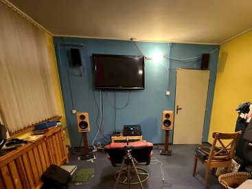

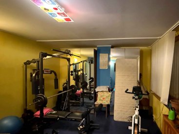

Hi,
I moved my listening room to basement and spent some time to find the right place for speakers and listening position, using REW measurements.
Now I think about some acoustic treatment of the room and I tried to use some available material (e.g. old matrices) to improve RT60 in front corners.
I measured before and after, and there is quite nice RT60 improvement.
Nevertheless, I am not able to interpret some results
1. There are some ETC peaks at 2, 5 ,9,7 ms. Is it possible to guess the causes?
2. SPL for 80-100Hz is nicely compensating in L+R measurement compared to individual channels, while for 10k Hz it is the opposite, L+R create dip. Any reasons?
3. Any suggestions for acoustic treatment?
I plan bass trap to front left corner and panel to front right corner with doors. Something on front wall and front ceiling. Probably curtain over windows. Not sure what to do with rear wall.
My room is 5x3,7x2,5 meters, most of left side are windows.
Speakers are 60 cm from left wall, 90 cm from front wall, 180 cm aside. Listening position is 230cm from front wall and 150 cm from left wall.
Any help is highly appreciated, as I am not able to find out more, even with AI help :-(
Measurement and photos are enclosed.
Many thanks
Marian

And BTW, it's probably not my place to criticize, but your TV is mounted way too high. You want your TV to be at eye level.

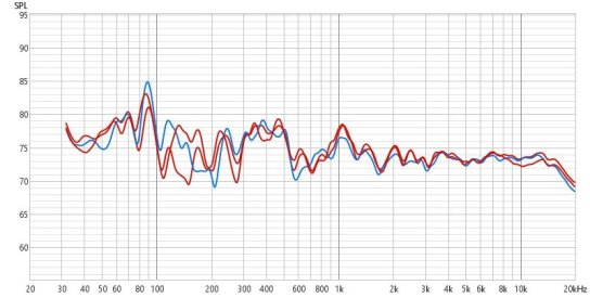

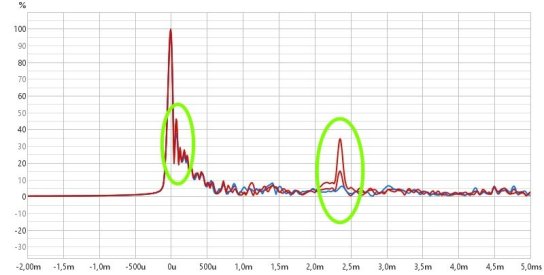

Hi,

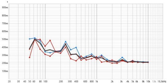

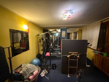

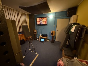

I have done some temporary/testing acoustic treatment and made new measurements.
I aligned the speakers with +/- 1mm precision.
There are bass-traps in corners, some ceiling and first reflection treatment and the back wall treatment is via free standing panel.
I am quite happy with improvement of RT60 (could be better but not so bad).
SPL is mostly within +/-5 dB, with peak on 90Hz, which can be limited by DSP.
I am still puzzled by ETC. I have no idea of peak on 74 micro sec (=2,5cm). Could it be reflection from Microphone stand?
Or some measurement error, I use 90 degree miniDSP MIC position with appropriate calibration file, 75 dB level for measurement.
There is also peak of left speaker on 2,4ms (82cm) which I was not able to identify.

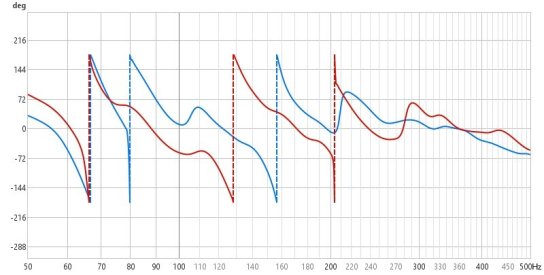

As with the previous measurement, there is also "out-of-phase" within 65-200Hz.
Would you have any idea on ETC and Phase?
Thanks a lot
Marian

Good work on your latest set of measurements, it looks as if you have learnt a lot. Keep it up!
If you are using your mic at 90 degrees, as you said you are, it seems unlikely to be due to the microphone stand although I guess it could still be possible. It is also possible that it is an internal reflection from your loudspeaker, or poor time alignment between drivers. I wouldn't worry too much about it.
From your photos it is likely to be your left wall.
Yeah, this is a problem. Take a look at this:
Red = L+R. Faint blue = left, faint green = right. We can see that when the speakers are playing individually they are about 3-4dB louder, but when playing together there is phase cancellation.
The phase curve tells you why. You can see that <70Hz and >200Hz, the speakers are in-phase with each other. But in that band in between, they are about 45deg out-of-phase.
Unfortunately that is going to be a room issue, most likely because your speakers are set up asymmetrically in your room. It doesn't look like you can do much about it because there is a door there. Perhaps if you reverse the layout of your room - speakers against the other short wall on the opposite side of your room (i.e. against the mirrored wall), and gym equipment near the entrance - you can achieve better symmetry.

Look at that, two of your measurements labelled "right speaker" is more or less the same as three of your measurements labelled "left speaker". So at this point I should get on the forum and accuse you of mislabelling graphs, right?
... except that the SPL graph of all your measurements labelled "right speaker" are exactly the same. Not even 0.1dB apart. This basically makes it impossible for a mislabelled left speaker to be in this collection.
This is bizarre. How can 5 measurements with exactly the same SPL response have two different impulse responses? There is no acoustic explanation that I can think of. It's almost as if REW mixed up the impulse responses but grouped all the frequency responses together. This should basically be impossible, unless there was some bug mixing the display of measurements? The mystery doesn't end here. If we look at the measurement of L+R, we once again see the SPL response is exactly the same, but there are THREE different impulse responses. Short of a bug in REW, I have no explanation. Sorry.
Clock adjustments are all over the place, anywhere from -3 ppm to -255 ppm. That will alter the shape of the IR but won't change the energy, so the frequency response is not affected. Difficult to say why the adjustments are varying, perhaps there are dropouts in replay or capture.
From a faulty microphone perhaps? Should we advise the OP to try another USB microphone?
Would you have any idea about ETC peak around 80 micro sec?
Assuming this is not a typo and you actually mean 80 MICRO seconds (and not 80 milliseconds). 80us in which measurement? If the peak is in the L+R measurement and not in the individual measurements, then it's a non-centred microphone.
If it's 80us in an individual speaker measurement (i.e. it is occurring VERY early), possibilities include: improper driver time alignment, ringing from one of the drivers (this is normal), internal cabinet reflection, etc.
I wouldn't worry about it.
Anyway, it's very interesting that the long USB cable was the culprit. I didn't know it could do such a thing. Can you please clarify if the long USB cable was on the microphone, or to the DAC? And also, how long was the cable?
