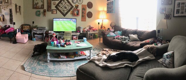

Also below I attached a picture of my living room with my current set up to give everyone an idea of the space and what I am currently working with (ignore the mess of my daughters things everywhere)
