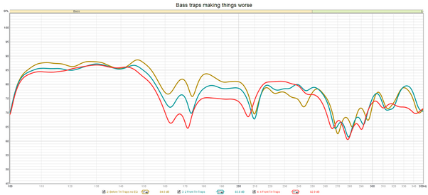

Hey all,
I've been struggling with my response in the above-subwoofer-but-still-modal 100-300 Hz range, so I decided to try loading my front corners with bass traps. It wasn't the drop-in affair I expected. What follows are some pictures and measurements to document the experience.
Here is the system before the changes. Room is 16.9 L * 10.6 W * 8.0 H in feet.
Now, we start measuring and adding the GIK Tri-Traps.
Wait, what is going on here? I thought I was going to improve in that area, not make it worse. Let's zoom in on the 100-350 Hz region:
Clearly I am losing output in the very area I'm trying to fix. Maybe the absorption is changing where I need to place my speakers.
(3 hours and countless speaker and chair movements later)
This seems like the best I can do. Let's run Audyssey up to 400 Hz:
An improvement over the previous effort.

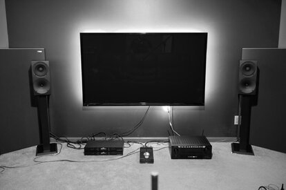

In the end, it is hard to determine just how much the corner traps did for this final measurement as they required me to move my speakers. All of the changes you see below 100 Hz are from moving the speakers, and a good portion of the changes above 100 Hz are, too. I think there is a synergistic effect though, as where the speakers ended up was not previously the best place for them. I would post waterfalls however they were corrupted by the noise from a wicked thunder storm as I was finishing up last night. Some other time.
I have not tried putting the Tri-Traps in the back of the room because there is no space. I thought it made the most sense to start at the front, but it's possible there is a greater benefit there.
Other notes: I am still getting used to the wide placement. I typically have them splashing the walls a bit so I get a big soundstage, as these were designed with their waveguide with great off-axis sound for small rooms (measurements here). With the wide placement, the toe-in is naturally greater and that has created some crazy center imaging. Vocalists may as well be standing in front of my TV they are so present. I am also getting less reflected and more direct sound, which is a bit brighter. I am used to these speakers being a little more laid back as most reviewers describe them. It goes to show how much placement can change what you hear. If you check the company's measurements against mine, you'll see how toe-in would lead to more treble energy, while more wall reflections (old placement) will lead to a greater contribution of off-axis sound which is down in level a bit, which leads to a more rolled-off in-room response.
However when discrete sounds hit the left or right speaker, they don't quite disappear as well in this configuration. I will probably play with this more at a later time. Full-range measurement:

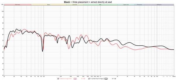

If I can figure out my remaining modes I think I would be looking at a pretty great response for speakers-only. My nemesis right now is the big one at 90-100 Hz that I believe is a width mode down the center of the room. I think I could kill it once I get subs back in here (picture one under the TV), but that requires a higher crossover than I was planning on using. Any ideas?

Moving the speakers forward creates more problems due to SBIR. As a bass source, they need to be near boundaries. Sub placement will be both front and rear.

The effects of the "bass traps" is mainly visible on "room decay" where this treatment reduces reverberation time. This relation between treatment and result is much more straightforward than looking on the SPL. The SPL curve will show a summ of all the effects so it will not lead you to the goal directly. Increased aborbtion will decrease SPL where it was previously gained by improved radiation efficiency and/or constructive interferrence, but it will increase the SPL previously decreased by destructiove interferrence....
I will post some waterfalls when I get around to that (need to pull the absorbers back out of the room again to do an A/B measurement, and the speakers have to be moved to reach them). Until then, this makes sense. Putting absorption in the corners is like moving a speaker further from the wall, or putting a speaker in an open space, so it makes sense that I would lose some reinforcement. However, I didn't see any areas where SPL increased.
with the free standing loudspeakers it is usually the best to move them away from the walls, which minimizes the effect of 1-3, then increased absorbtion will not affect the direct sound. But in small room, if you may afford this, build a plaster-board (angled for optimal aiming) pre wall and flush the loudspeakers into the wall. In this case you will eliminate the problems of diffraction, SBIR and 1st reflection from the front wall and and you will signifficantly improve damping bellow 100 Hz.
The reduction in SBIR was my goal, and putting the speakers closer to the walls has achieved that. I used to have big cancellations that disappeared using this method. I don't have the room to build a false wall, though. Maybe in a future home I can have flush-mounted speakers with perfect bass response.

Location has already been thoroughly explored, trust me. Many hours...days. :)
