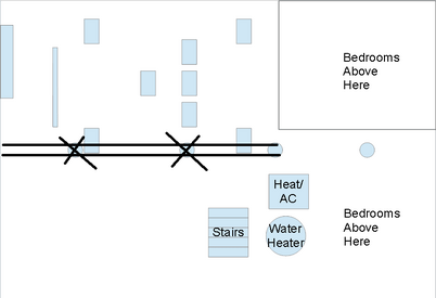

Just my thoughts. If it was MY place, I would run a new (sized) beam over the first two post places to carry the load and lose them.. 24 x 22

like this....

Thanks, leecreek, not out of the question. That would really open up the area. Just not sure how ugly the job of moving one or two support columns would get.

What's your ceiling height in the unfinished basement space? Lee's beam suggestion could work nicely but may decrease your ceiling height quite a bit in that area. We did this in part of our basement to remove a column from the middle of what will be a family room. The steel beam is somewhere around a 11ft long and 1ft tall and cost around $800 I think. The job wouldn't be too ugly for a crew that has done it. If the space is unfinished there should be minimal surprises in terms of the existing structure. I'm not sure how much harder removing two columns is compared to removing just one.
edit: A steel beam certainly isn't the only option, depending on the construction of the house. Just one example.
5,175
I use and LVL above my room... about 20ft long... 4" x 12" and I believe it was around $200 back when I built the room. They also used the same beams outside on our carport when we built it after losing the garage. You can get them just about any length, and I know 24ft if available. Of course you have to be able to get it in the basement.
I like the beam idea best... and widen up the area some.

First the fireplace: It stays (not going to tear it out) but will not be used (there is a matching one in the living room upstairs and a gas one in the family room that its the extension on the rear of the house), and I have no problem in covering it non-destructively with treatment material or a second wall spaced in a couple of feet. Could make for a killer bass trap at the same time. The main body of the fireplace sticks out 1 ft 9 in, the base extends 3 ft 0 in into the room. Hmmmm, that is farther than I was thinking, that thing is eating up some serious real estate. Hmmmm.
MOVING THE BEAMS!!?!!&!!@!!
  • Getting a beam into the basement is not an issue in this case, a double-door entry into the adjoining room from outside and a single door from there into the room shown in the diagram give a straight shot for hauling in a hefty beam. I assume on rolling cart(s)?? You will not drive it in on a flatbed with a crane, though.
  • Height to the bottom of the main floor joists: 7 ft 4 in.
  • Height to the bottom of the support beam (several wood beams now) that runs down the center of the house: 6 ft 4 in.
  • Some duct work and plumbing will have to be moved, but that is small potatoes next to moving the support beams.
Instead of putting a new steel floor support beam UNDER the existing wood floor support beam that runs down the center of the house, how about adding two steel beams, one on either side of that wood floor support beam? Each would have a vertical steel beam holding up each end. Four new poles to replace the two removed.
I'm tired, I'll draw some diagrams tomorrow to show what I am thinking.

You can "'nest" a beam in where the original construction was just laying the floor joists across the top of the current beam. Meaning if the floor joists are 2x12 laying across the existing beam, you can put temporary walls in, remove old beam, cut the ends of the joists off to fit the width of a new beam and anchor the floor joists with joist hangers to the new beam. All tucked up to the floor. The amount that it would hang down is dependent on the load requirements as engineered. A competent contractor would have no problem with this as it is getting more popular on renovating old homes for a modern open area.
This sounds like a possible solution. It could yield a ceiling height of 7 ft 4 in, or thereabouts, with 2 old support beams eliminated.

leecreek: the more I think about it, the more I like it. It took me awhile to get it pictured in my mind, your last post did the trick. Thanks for the detailed explanation. The new place will be in Marion, a half hour east of Asheville, where one son and his family live. I will PM you when we get settled in.
