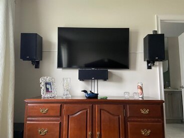

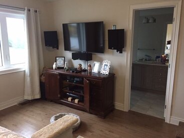

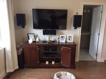

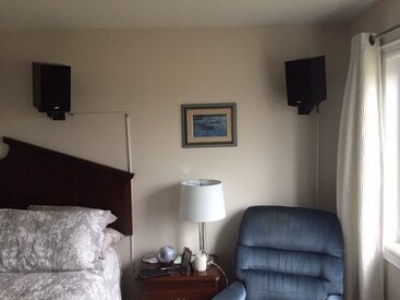

Here are some pics of my system in my bedroom. My late wife hated that I had the equipment on the dresser and she gave me the idea to partially repurpose the dresser. I had to remove the 3 drawers in the middle to accomodate the equipment as well as removing the back panel as well because the AVR was too deep. After my wife passed, I pushed the bed over to the other side of the wall and I put up the surrounds. When I watch movies or listen to music, I pull the lazy-boy out in front of the night stand. It has felt pads underneath so its really easy to move. You will see in pics 5 and 6 where I had placed the sub. Its no longer there. I moved in the corner behind the lazy-boy.

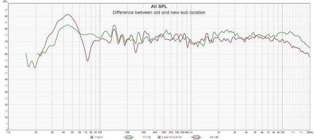

I used REW to find the new spot mentioned above in the room for the subwoofer.
Here's are REW measurements. The red plot is where I had the sub before using REW to relocate the sub. The green plot shows the response with the sub at the new location.

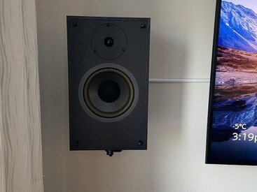

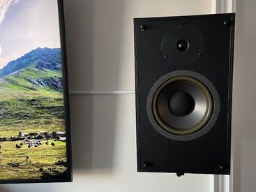

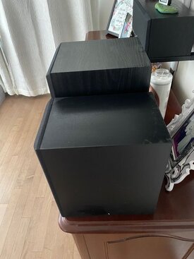

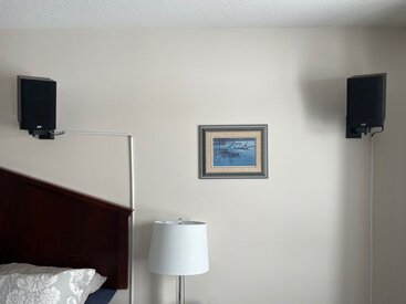

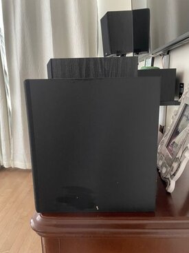

I finally took some time to replace the PSB Alphas used as surrounds to Alpha Minis
Here are the size differences... The Alphas to the left, the Minis to the right.
Before replacement
After replacement

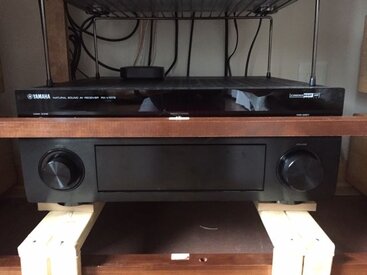

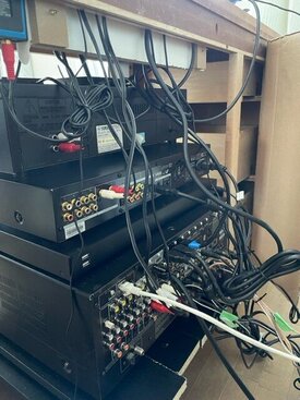

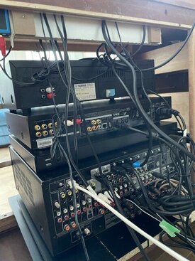

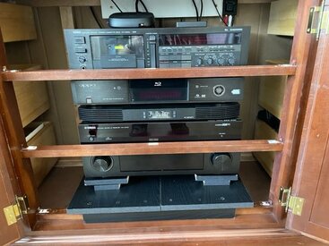

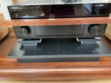

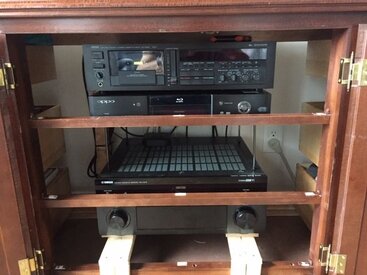

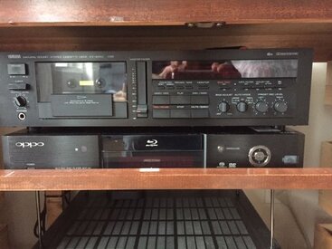

Remember the Infinity fan I purchased? Well, it came in yesterday and I read in another forum which I'm a member of that another member has the identical model and he could hear it from his seating position 8 ft away in between tracks. I placed the unit on top of my dresser/converted media console plugged it in and I was able to hear it. Sooooo, I decided to use it but to place it in my bedroom system for two reasons: 1) I barely ever do any critical listening there 2) Im tired of the rickety setup I had of a wire shelf being balanced on top of my AVR holding up a cassette deck and bluray player. It went from this
to this
I ordered a rear vent unit for the greatroom setup.
I have that unit in a front-exhaust. IIR you can set the maximum allowable fan speed? I haven't had an issue with noise.

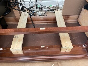

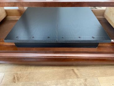

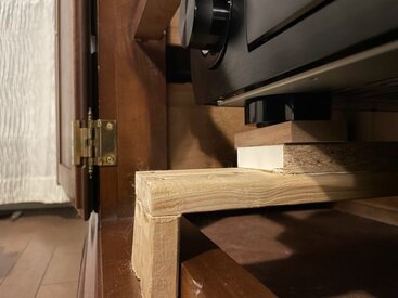

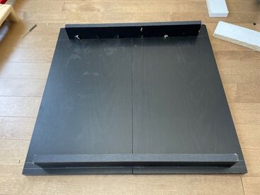

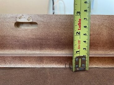

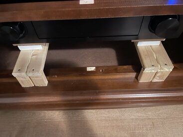

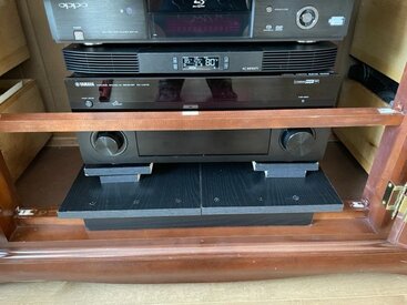

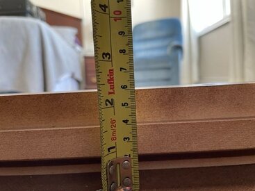

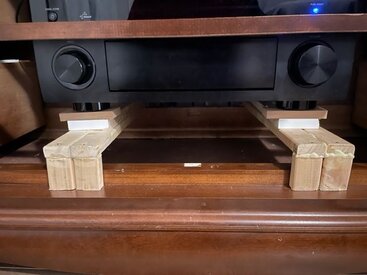

I redid the shelf support in the dresser. The before shots:
