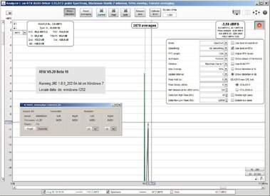

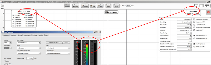

I did some measurements using Victors (vicnic) 10kHz oscillatort (more on DIYaudio Low-distortion Audio-range Oscillator thread posting #203).
With "Averages: Forever" REW gives a carrier level of +5 dBFS - what's that?...
The input level is about -3 dBFS all the time.

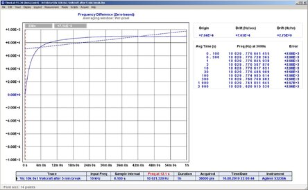

k2/k3 level was changing over the time.
Lowering in most case significantly.
This is most likely caused by the fact that the frequency drifts a bit:

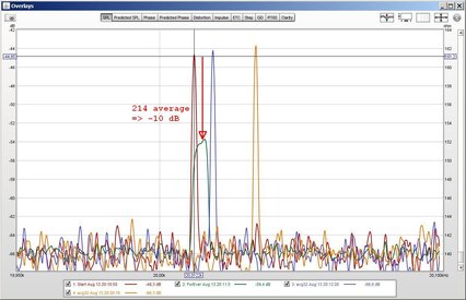

Focus on k2 gives this:
  1. -45dB at the beginning
  2. lowered to -54dB after 214 sample forever average
    I do like this green shape ,-)
  3. and 4. 32 sample average give more or less the same k2 level as with the first measurement

I couldn't reproduce that using beta 3. I'm not entirely sure how it can occur unless the ASIO driver delivers values greater than 1.0. Is that possible with the RTX, perhaps if the range changes?

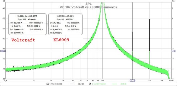

It all started some days ago when I wanted to see how Victors oscillator copes with different psu.
The k2/k3 drop did not relate to the psu used...
Didn't see that with Arta using the same RTX6001 with the same setting...

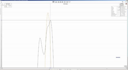

V5.20 Beta 19 works just fine - even with more than average over 20.0000 samples
Has potential to be one of these unsolved issues ,-)
